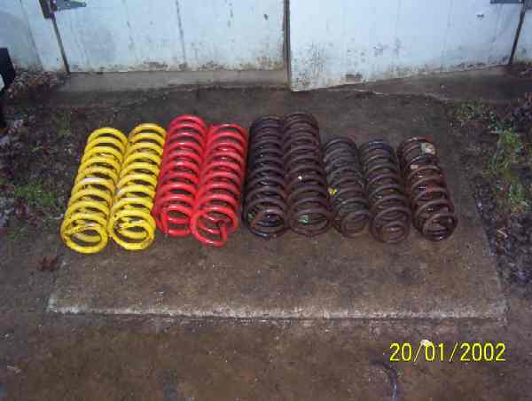

Here are a couple pics that I took of different springs... they are arranged according to the size of the springs (wire diameter - not just length - as wire diameter - carry capacity - the first two sets are too heavy for the Ex...)
The yellow ones on the left are 3" lift for a mid 80's full size Bronco
The red ones next are 3" lift Ranchos for a 72 Early Bronco
The rusty ones next are stock mid 70's F 150
Next comes a set of stock 92 Explorer
And finally, the single spring is stock 86 Ranger STX (factory 2" lift - note the spring spacers - and the fact that there is only one spring - and it is OUT of the truck... :thumbdwn: )

GLF, The F150 coils, any idea how they affect the ride height? whats the free height? Looks like they'll have plenty of droop, assuming the rate is light enough to compress them at rest... I keep coming back to coilovers tho. By the time I add a couple Bilstein 7100's to each corner, I might as well start with CO's. Around, and around, and around, and around....
