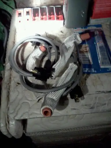

I don't see how .i have spare fireproof wrap laying around.ill dye it and torch it and see what happens.they don't get that hot on ours.
haha @ xeek, they look like socks! rofl
jd, let me know, cause if i can then ill get white/beige and dye em, but says makes them fireable.
Like i said this has been all in my head....but i don't see how,dye changes the molecule structure of fiberglass.only thing i can think of is the paint has ceramic base but dye is different.i would think the fiberglass would ignite before the dye chemicals would.Idk this is all in my head...no research

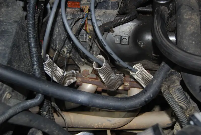

Hhaaha they look dumb but believe me that header flang gets real hot and they will dry your boots up quick.i tested his wires before this and it looked like a lightning storm!!and im pretty sure i have a bad boot too and my wires are NOT cheap!!

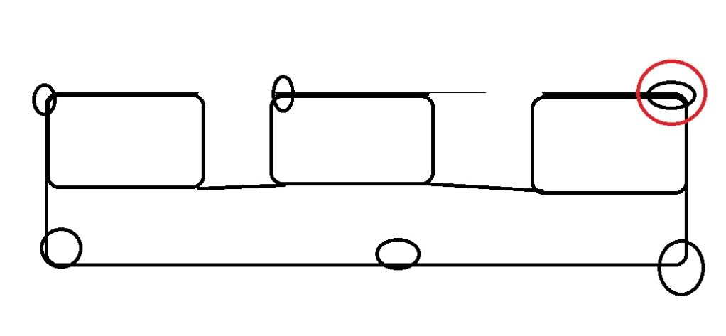

Witch bolt is it?take a pic
bad drawing... but here is a paintshop drawing.. ill get a pic in a few mins, had to come in and eat
edit: passenger side closest to the grille
I can't believe vise grips didn't work.did it round the bolt or the vise grips?you tried heat and wiggle it back and forth,tightn,loosen,tightn,loosen.smack the head of the bolt gently like your nailing in a nail,might wanna do all three.heat the his out it,wiggle it wile tapping on it.or might just have to let it soak over night again.
Its busted... right where the threads started on the bolt. it snapped, clean snap... I soaked it over night and few more hours with PB, torched it for about 20-30 mins 3 times.. i have wiggled it, smacked it a few times, tapt on it, the small vice grips, it flattened out the vg, the larger pair made the broken bolt/stud smooth.
Dang.worst case you can make it all smooth and tap it new threads and use it as a stud and put a nut on it.the old manifold is way thicker than the new headers so you should have enough bolt sticking out
pics would greatly help right now. just when i think i understand what it looks like, you say something that makes me think something else.
and yes, jd is right on hitting it. a buddy told me that trick. mine wasnt broken but same result. put something on the tip thats bigger and give a few good wacks of the hammer, but not to hard. then tighten and loosen with whatever tool that can get a grip.
going now.. and will post within a few mins.
