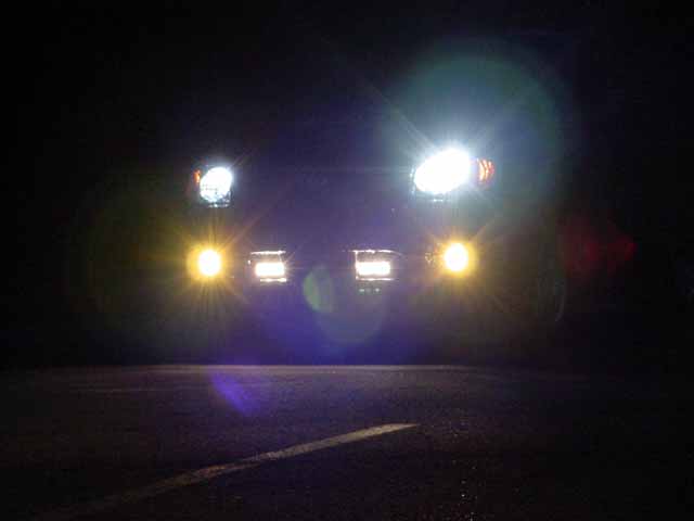

In the image shown below, Headlights are 8000k True High/Low HID's. The stock fog lights are yellow 9005 bulbs, and the middle lower lights are PIAA 980's Fog/Driving Lights w/ PIAA Bright White bulbs.
Look how much cleaner the HID's are than the PIAA's. And they are PIAA's Bright "White" Bulbs. They don't look to White to me. Not next to the HID's

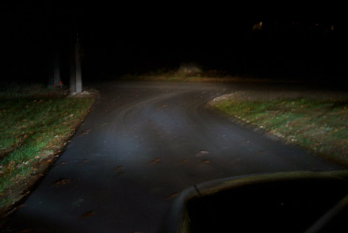

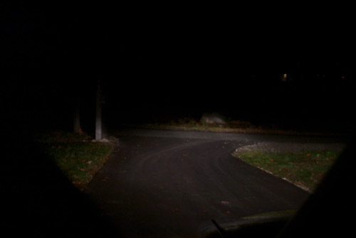

Sylvania also makes a Xenarc HID auxilliary kit that acts as another low beam. The system has a remote so you don't need any extra wiring into the cab and you don't have to remove you fog lights. The system is $300 but the light output is fantastic. It took me two hours to hook up and that was mainly to find the location for the ballasts. I have the silverstar headlights which are great but combined with the new HID light I can see so much more. With the remote, it means you cna have them on with both low and high beams as well.
Please post some pics of this install.
I will take them tonight and email them over tomorrow morning.

Here are your pics... this post anf the next two.
and....
Note: I am just posting for a friend, he will need to explain the pics.
