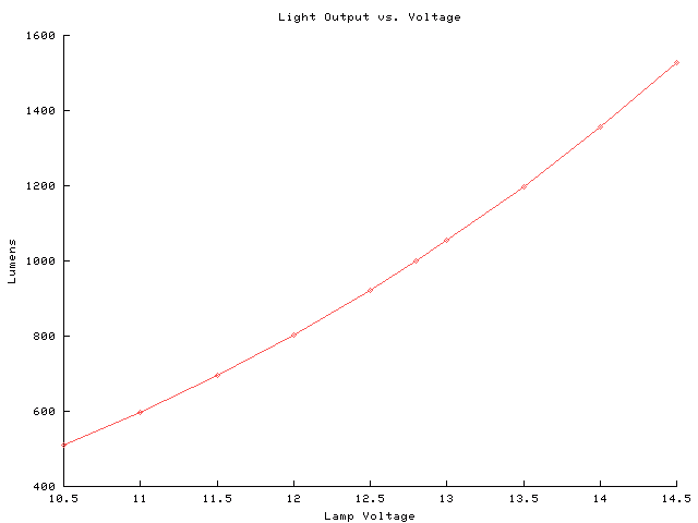

Harness Info.
A heavy duty harness will increase the volts to your lights and the increased volts will make the lights brighter.
You should increase the volts by at least one volt. That will increase the brightness by 30% or more.
It will make a difference.
