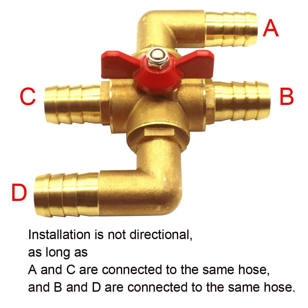

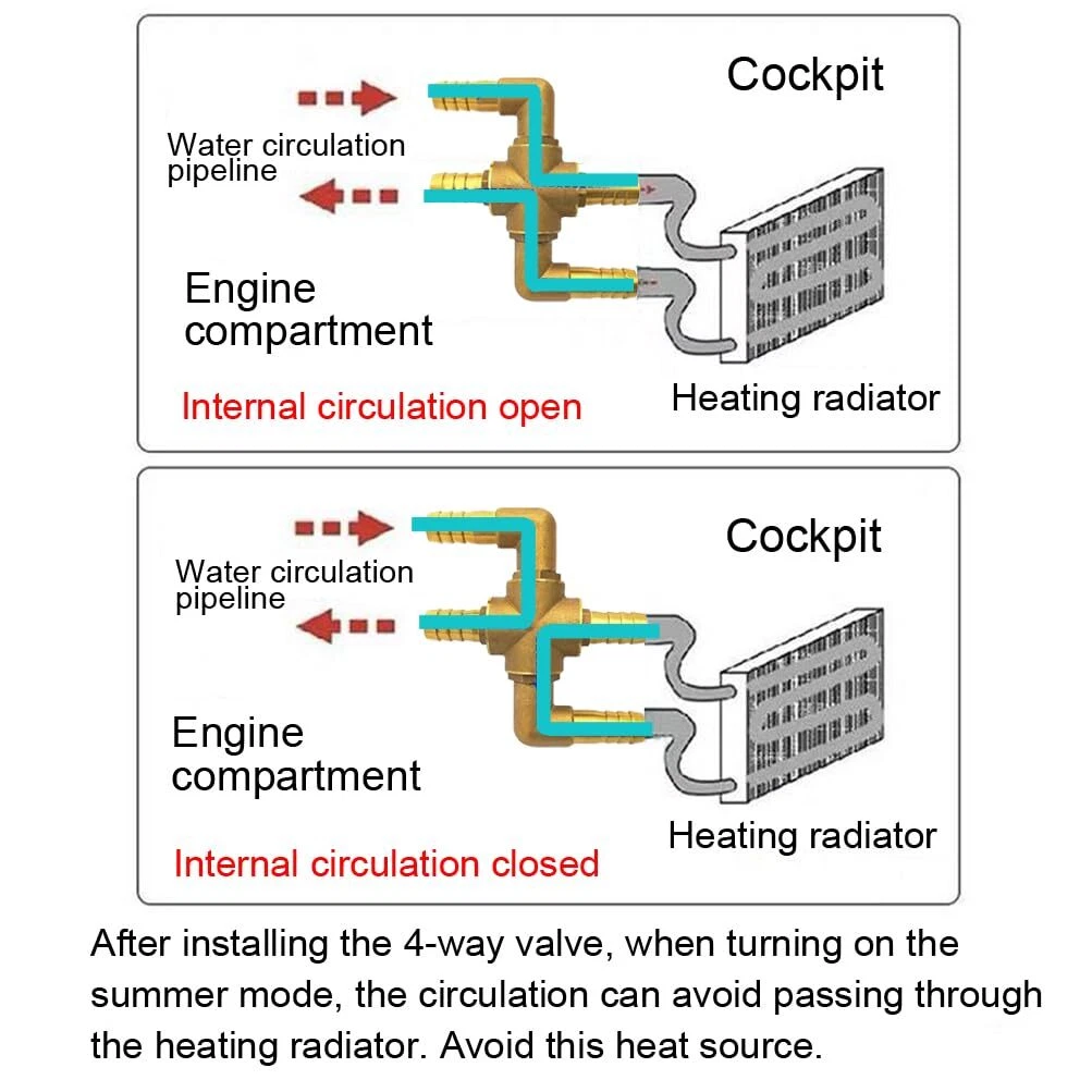

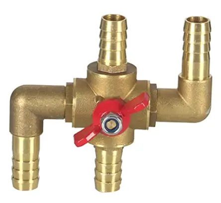

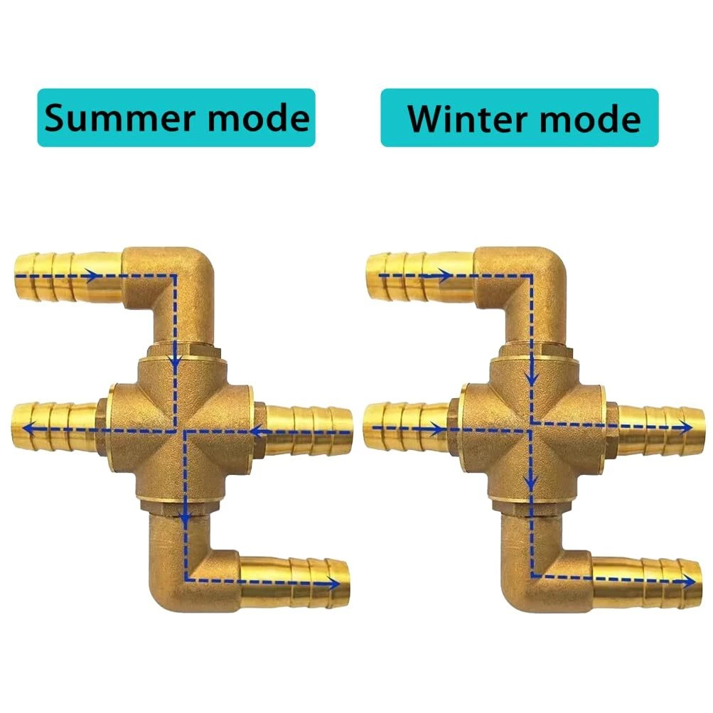

Found this...the kind of construction (all brass) I'd prefer...something for me to think about, never knew such an animal existed.
