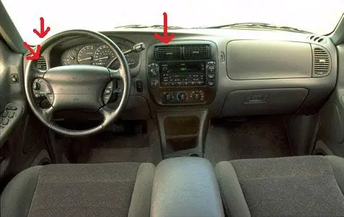

I am having a similar problem, the rear console vents are working fine the right side vents in the front are working, but the driver side vents are not working the one above the headlight switch is dead and the center left vent above the cd player is dead also the vent that defogs the driver window is dead. I have a 1998 xlt 4.0 sohc what could the problem be?
To Southeast, sounds like you have a vacuum leak somewhere in the system. This would cause the internal dampers in the HVAC system to not open or close fully to redirect airflow to the different vents. Good luck finding it!! I had a similar situation that turned out to be the brake booster leaking, causing loss of vacuum in the entire system (and spongy brakes). In my case, I was getting a small amount of air flow out of the defroster vents regardless of setting on the dash.
