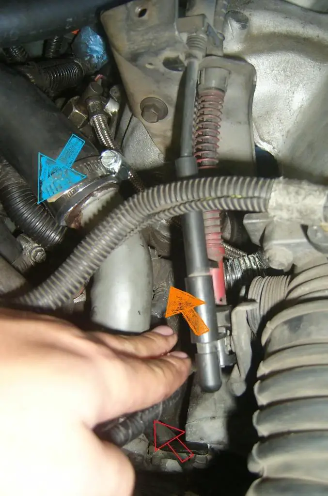

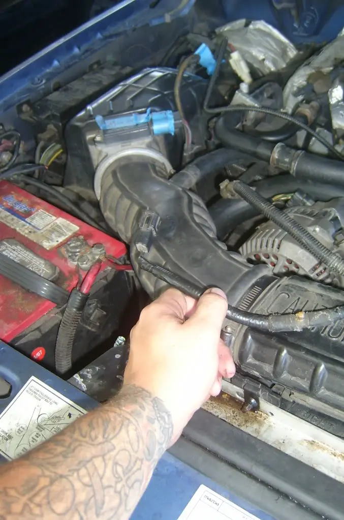

OK here goes, the offending cord is in the first picture. the second picture shows the engine wire harness (blue and orange arrows) and the cord (red arrow)

crankshaft postion sensor is what that wire is the sensor is right above the harmonic balancer ( that can give you starting issues..it tells the computer when a cyl is about ready to be fired from the plug )
just looked at mine and that wire loom runs right down to it ....other than that it can't be going to the a/c .they share almost the same loom but different connector end tho .
sure enough that's what it was....now its running really rough and misfiring...should that be normal after a head replacement? or should it run smooth right off the bat? hmmmm time to check spark gap
