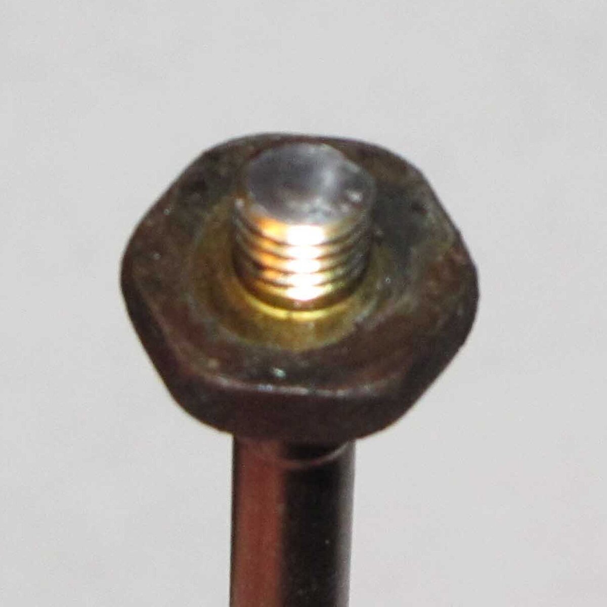

Hello,
I would like to replace one of the bolts from the power steering pump bracket because it is broken. This is the left most bolt when looking at the bracket from the front. It has a ground wire of some kind attached. Here are some pictures,
This is not one of the W710927-S437 mount studs like this one,
2002-2014 Ford Power Steering Pump Mount Stud -W710927-S437 | Rockwall Ford Parts
There was a washer and nut holding on the ground wire, but the fixed nut is much thinner than on the typical studs. The nut was rusted on and despite allot of PB, I managed to twist off the end of the bolt trying to remove the nut. I would like to replace it with the correct part but I can't find this part listed in any of the diagrams.
This diagram,
STEERING GEAR & LINKAGE. PUMP & HOSES.. 2002 Ford Explorer XLT Sport Utility 4.6L Triton (Romeo) V8 A/T 4WD | Lakeland Ford Online Parts, Lakeland FL
shows the bracket as part number 7, but none of the bracket mounting bolts are listed. The pump mounting studs are listed as parts 4 and 5, but they are not what I need. How can there be a specialty bolt in this setup that is not in the parts diagram?
Anyone have any idea what the correct part number for this is? Would this be listed in some parts diagram other than the power steering diagram?
