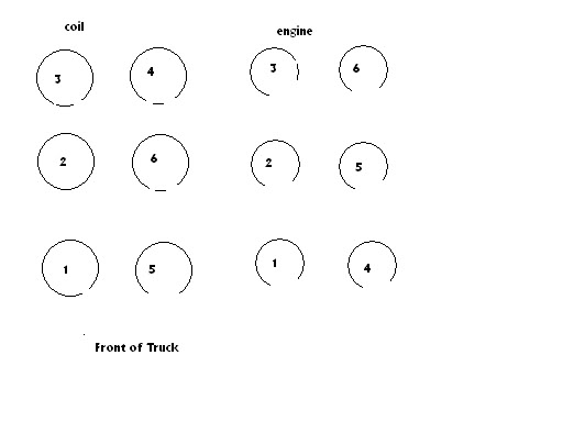

i rechecked the plug wires and i thought they were correct, however, i disconnected all three wires on the drivers side from the coil and the engine actually ran a lot smoother only running in the three passenger side cylinders. i hooked the wires up so that the number printed on the coil pack went to its corresponding cylinder number. i looked at this site for the cylinder numbers:
http://www.therangerstation.com/tech_library/FiringOrder.html
i must be missing something here, did i do this correctly?

since the engine runs smoothly on the three passenger side cylinders alone, i am assuming everything on that side is working properly. i plugged the three wires back in for the drivers side cylinders and started the engine. it was obviously still missing, so i started to unplug the drivers side plug wires one at a time. when i removed the #4 and #5 wires, there was a noticeable change in the way the engine ran, but when i unplugged the #6, the was only a minor change. after doing this a couple times, the engine started to run smoothly and seemed to stop missing, so i took it for a drive. it is definitely better than it was, but when i get on it, it starts to miss pretty bad. now it seems like a bad coil, and if it is, i'm sorry i wasted everyones time, but i don't understand why it ran so much worse before. initially, it felt like it was running on 2 cylinders. now, when it misses, it still feels worse than just one cylinder, but at least it doesn't feel like its gonna blow up. how do i test the coil to see if that is the problem?
I think you still have the wrong firing order, I'm not sure where you found that site but i think that's where your problem is.
This is the correct firing order (from the haynes manual), I used it when i did an engine swap in my ex:
I'd tend to agree with the possibility of the firing order being wrong. It's an easy mistake to make since the one side follows the coil order, and the other side swaps things around.
