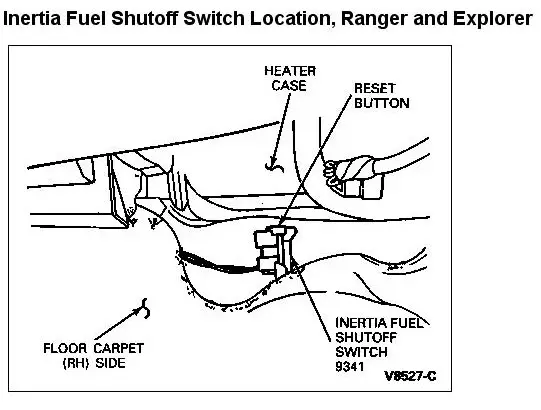

The first thing to possibly check is to make sure that the fuel reset hasn't been tripped somehow.
How do I check that?
Technically, it is the "Fuel Inertia Cut Off Switch". It is supposed to cut off the fuel in case of an accident. On my '95, it is on the firewall, just to the right of the tranny hump. Your location may be a little different. The Owner's Manual should tell you exactly where.

Well i checked the Fuel Shut-off and it was fine, I checked the Fuel Pump relay, which in my manual said was a 20a mini fuse in the distro box, and that was fine. What could be causing this problem? How do I check the O2 sensors and Fuel Pressure? I'm starting to get frustrated....
