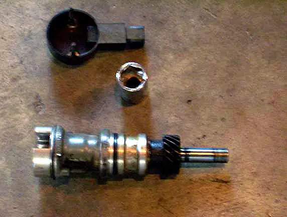

She fired up withut a squeek this morning at 8 a.m.
Spinning the old part by hand I can deffinately tell that the bearings were shot!!
Here is a picture of our offending part. It is a bit wierd as I had to digitally brighten the picture up. Thje long piece is the drive body. The cap is the Hall effect sensor (cam position sensor) and of course the thing in the middle is a 19mm socket for scale.
davidmmm69 said:
camshaft position sensor?
what a good guess I had Finally.lol...
