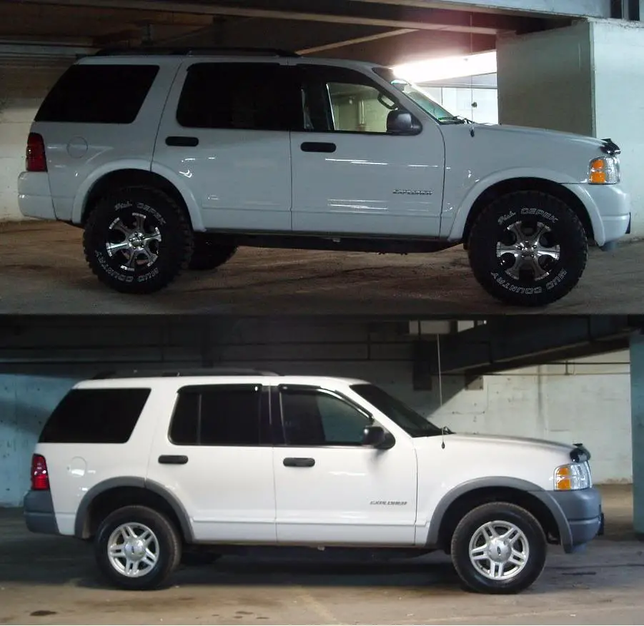

You can even notice on my X, I lifted 3 inches in the front, and 2 in the rear, and the rear is still a fair bit higher.

My tires will fit on your stock rim, but I'd at very least recommend putting wheel spacers on. (and a lift)It would be to tight to turn your wheels otherwise.
Other than my lift, tires and rims I've only painted the bumpers and flares, put on a bug deflector, taken off the steps, and installed a stereo.
