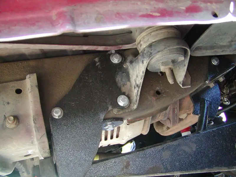

I need help!!!!!! when i put my superlift radius arms on a while back I didnt have any directions, well i have mounted the rear brackets on too far forward. Do any of you guys know how far back they are supposed to be mounted????? or have a reference point for the bracket. right now my mount bolt for the right side ttb is hitting the front drive shaft for the right wheel which is not a good thing lol. any help will be greatly appreciated. also i cant find any directions on the superlift site to download, thanks, mike

ok i did some searching and can i just remove the two back rivets on the cab mounts drill the holes and mount like that, will this place them in the correct position? thanks guys
Here's a pic of my extended Radius Arms and the mount point, hope this helps. Sorry it took so long, but I am fighting with adobe photoshop and its crash issues ;)

Right on! perfect, thanks man!:chug: omg if you look at this pic really close you can seemine are on backwards lol. man duhhhh i feel stupid lol
oops here is the messed up pic
