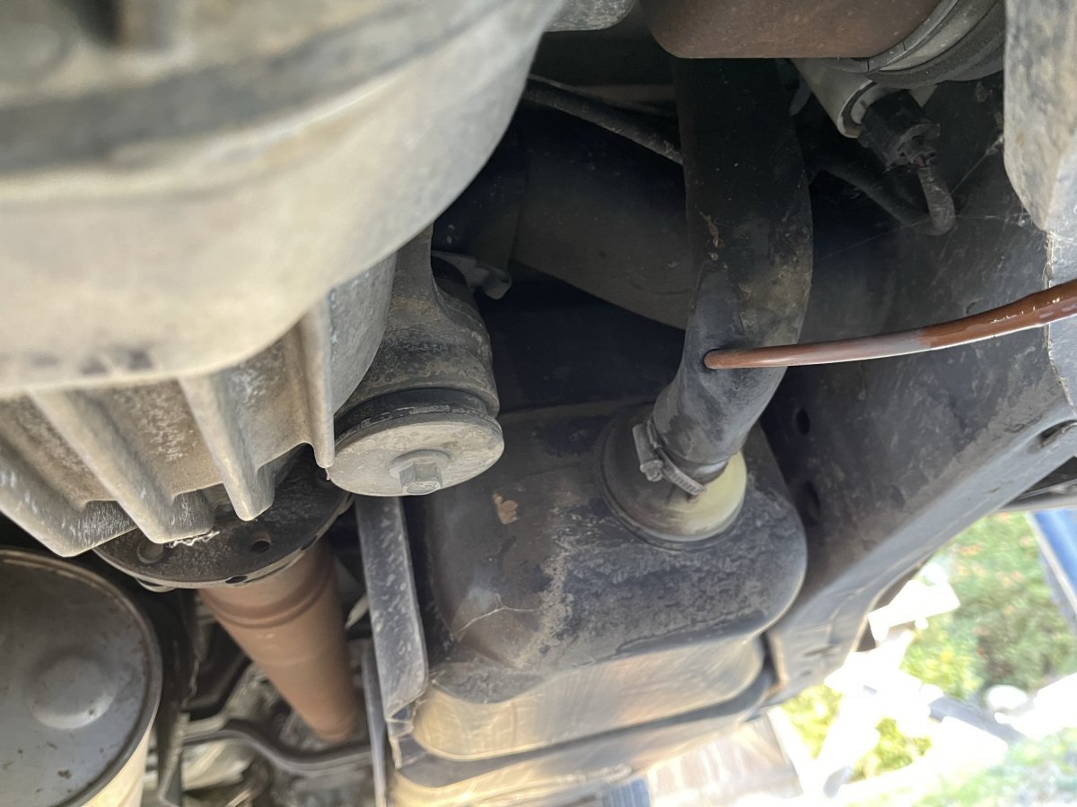

I'm the original owner of a 2005 ford explorer xlt. This morning I came out to a fuel leak from a small 1/8" broken line lby the rear differential . what is this line/vent? brown in color with no sheath. any ideas...

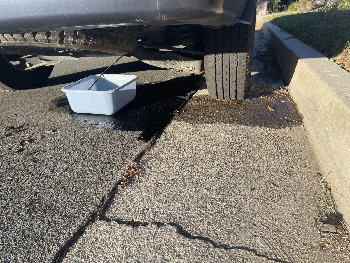

And yes, the mess was cleaned up before it went anywhere.

I'm not sure about the '05, but the 2nd gen Explorers had the fuel vapor recovery tank located in that area. My guess is that it's part of that system.

Maybe brake line? A photo of where that line connects would be very helpful.

Not brakes , fuel was leaking out of it and it is attached to the tank. had leaked quite a bit and a very observant neighbor put a bowl under it capturing a couple gallons of fuel. just really strange because the front gutter would have been filled if it wasn't cought early.
I'm dropping the spare and having a look around in the am.

Yup it was the vermin of society....
They went to drain the tank with a 1/8" drip irrigation line...
Somebody has no clue about fluid transfer rates and gravity...
