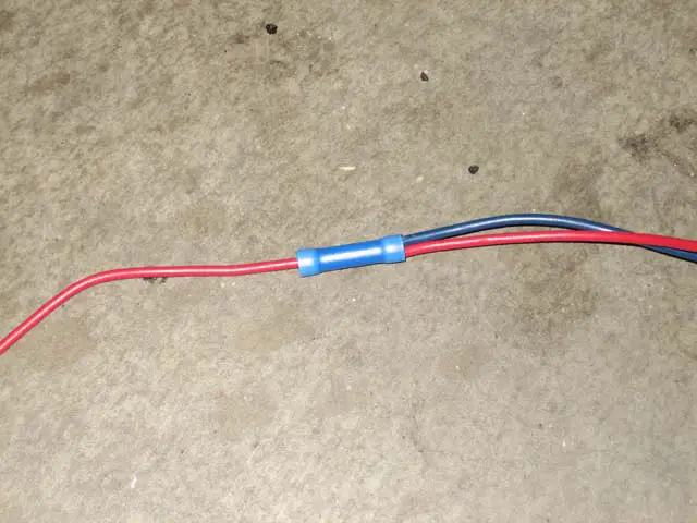

What is the best way to tap into that? Can one order the rest of the harness and power port from ford??
I just cut off the plug and tapped on the wire.. nothing wrong with that!
Used similar wire splice connectors:
