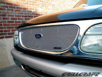

You dont have to cut your grill out.....im getting this one that goes over it:
Not too shabby, but I prefer the look of the homemade speed grills on a 4x4.
