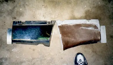

lol, im working, im working! yea, those are the guards that go behind the rear tires. on the left is the stocker. i used alot of fiberglass to "build up" the area on the bottom side, and used a cutout piece of 22 gauge steel as a guide to build the 'glass around. here is step one-

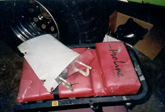

here is another- the dots are were you follow the contour with the 'glass...

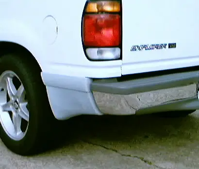

ok- for whatever reason my $50 web cam is actually taking legible snap shots today... so here is a pic. this is with the 1st coat of what will proly be 3000 coats of primer.lol
... and one more up close
looks good james...... a lot cleaner than the stock one with the moulding..and it paintable insted of the chrome covers....
That is pretty slick James, you need to make me some. :p
yeah, that looks really cool. id have you make me some, but mine are "integrated" into my fender flares. im just going with little tiny mud flaps that you can barely see (i had them on before, but i took em off cuz my front tires rubbing slightly on em.)
Looks good!
