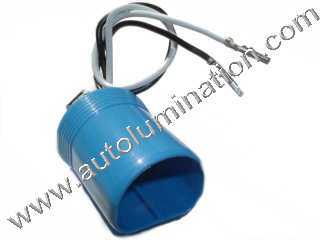

Pics1 through 3 basically show you how to make a pigtail out of a bulb. Another way would be to buy a pigtail already made, like this:
ok so it wont interfere w/ that sensor then, that sensor is in the dash next to the passenger speaker pod and i understand the pigtail now it confused me cause dont see it in pic 6 or 7
As long as you don't have DRL, I don't see how it would interfere. Basically, the relay-based harness fires up a relay instead of a bulb. So if the sensor decides it's time for your headlights to come on, it will do its job by turning the relay on, which in turn will turn on your headlights.
Looking back at Pic 7, it looks like techboj used an aftermarket pigtail (bottom left) instead of the custom one.
