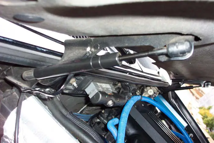

All hood shocks get old eventually. They loose the ability to hold a hood up. You never forget the first time a hood falls on your head. It really doesnt hurt but is sure does scare the **** out of you.
Replacing these hood shocks is about as easy as it gets. I am going to give it a 0.5 on the difficulty scale. It will take all of five mineuts out of your day.
New hood shocks LIST OEM for about twenty five bucks each.
All you will need is a tiny screwdriver, or some pick tools. Also a prop rod or a broom handle to hold the hood up.
( please ignore my dirty hood liner )

First observe which direction the shock is facing. Metal end up.

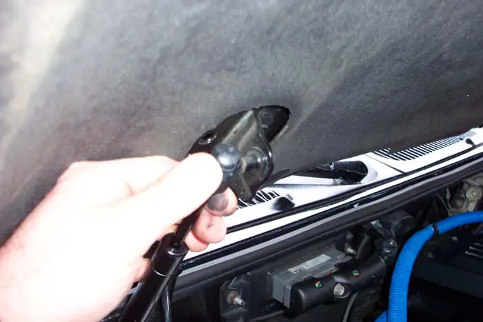

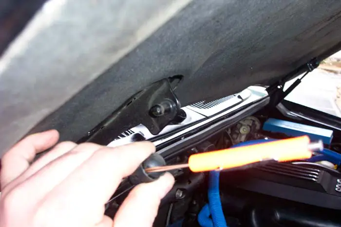

There is a C shaped clip that goes around a ball joint attached to the hood hinge. All you need to do is slide that clip back part way and pull back.
There is a handy slot to make it easy to get the screwdriver, or pick tool behind the clip. If the clip flys away, dont worry, the new shocks come with the clips on them.

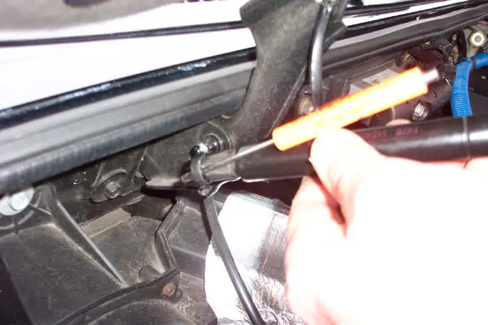

the bottom comes off the same as the top.
Slide the C clip back slightly and pull away.
Like I said the new shocks come with the C clips on there, so all you do it push it on with a little bit of thumb pressure. No tools needed. A little dab of grease or speay lube on the ball joint wont hurt either. The other side is just as easy. Cake job.

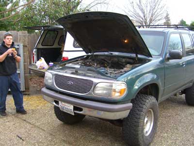

Monmix.. look what you did.
I haven't seen this happen for a looong time. Plus, I got them for $8 each from Pepboys through a buddy's hookup. :cool:
