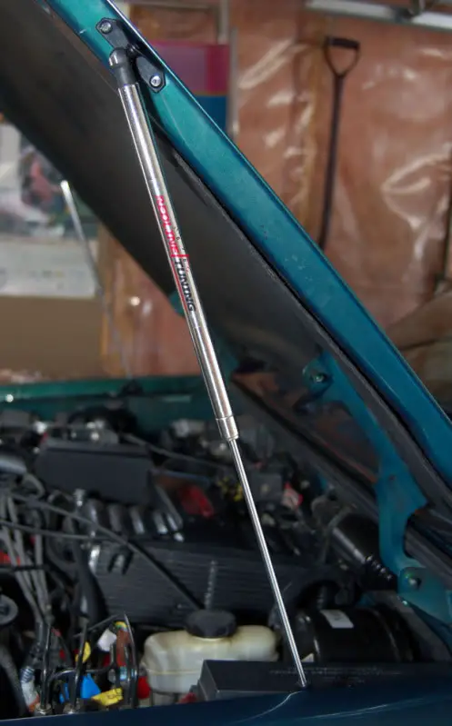

Worth every nickel. I've got them on my '99:
You get what you pay for. They hold up your hood with authority. :thumbsup:
