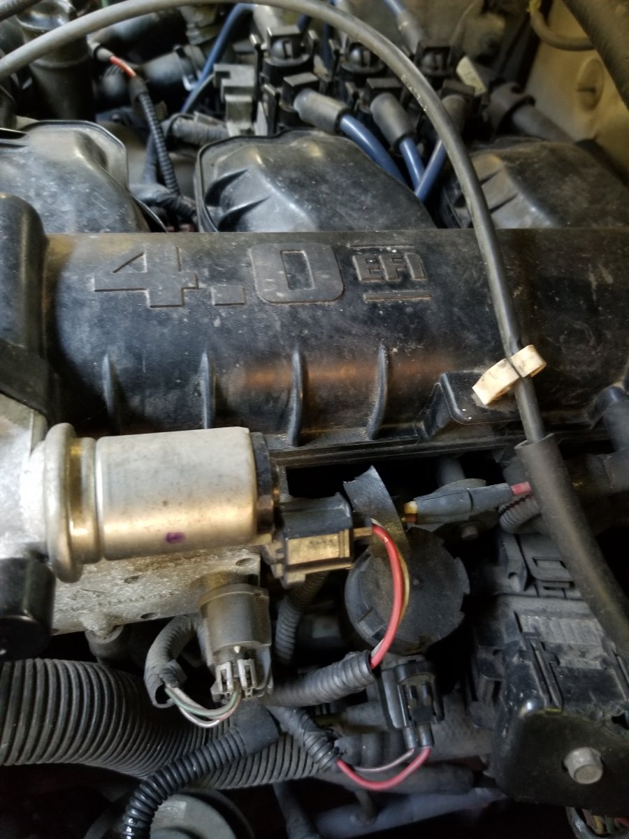

Question: The parts suppliers ask if it's a SOHC or DOHC. How can I tell? The marking on the valve cover doesn't say. I don't see it on any of the specification stickers under the hood or in the door jambs.

4L OHV will say "4L EFI" on the intake.
4L SOHC will say just that on a cover overtop of the throttle body. if you dont see any on the intake tubing then its a 4L SOHC.
Thanks! Sorry but I'm a little fuzzy on the terminology, but I think the 'intake tubing' is the ribbed tubing running across the front of the engine bay. This means the pictured cover is the 'cover overtop throttle body' and therefore a SOHC? Just want to be sure and didn't realize I could post a pic.

That is a 4.0 OHV.
there was never a dohc 4.0 in these. only overhead valve and single overhead cam

that is the intake tubing. thats where i was saying if it says 4L efi, that means you have a 4L ohv. if the guy is trying to tell you its a dohc, get a different parts store.
Thanks guys. I think I got it. The choice between OHV and SOHC seemed confusing as I am new to this series of motors. I appreciate the education.
Ohv = pushrod engine the cam is below the heads
You have ohv which is the good engine to have in 98
Ford made it tricky by offering two different 4.0 v6 from 97-00
2000 was the last year of the ohv, pushrod whereas the sohc engine went until 2014 I believe
