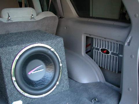

nope no power light at all, the only prob is where my amp is its not very convenient to get to. but i pull off my panel and check tommorow and see if i blew a fuse on the amp and see if i can get my HU out:rolleyes: here is where my amp's at
