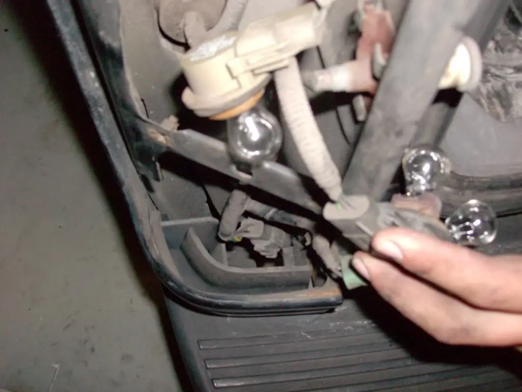

im going to try and get a picture of what i tried and ill put it up here
lets see if it will embed this time. the connector on the bottom that i am not touching is the one that i tried disconnecting
Nope, thats not it. It is a ROUND connector, bigger than the one your referring to.

Did you look from underneath? It will be behind what you can see in that pic. You just wont be able to see it by removing the tail light.

my 98 xlt has the trailor package but the plug gmanpaint is talking about is behind the driver side break light. i just pulled my light unit out and there it was after pullling it up some...
yeah, the same grey plug as in the picture. the only difference is that mine doesnt have the wires for that but i could just change the wires out with the towing wiring harness
well mine is a big round plug.. almost as big as the bulb in the pic so urs must be different then what is in mine. mine has its own plug for it if i get around to it ill get a pic to show u what i am talking about
