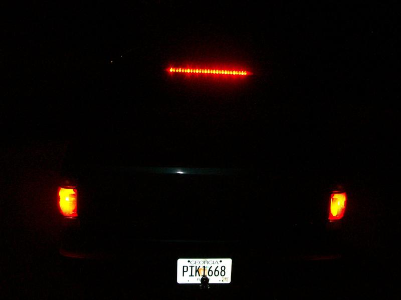

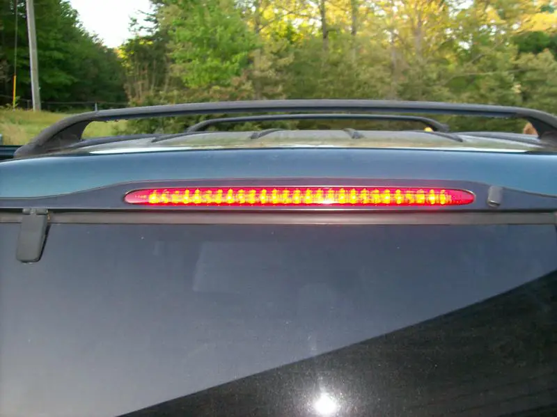

Update:
I finally got my led strip in this afternoon’s mail. This was the right choice for this application. It’s totally sealed, cut-able to the prefect length and has a 3M adhesive strip on the back. I cut off 3 bulbs, stuck the strip inside the light housing and ran the wires out of an existing hole. I then tested it with a small 12v battery and it works perfectly. I glued the lens back onto the housing with clear silicon adhesive, sealed the wires and clamped it together. As soon as the glue dries I’ll install it back into the rear trim, plug in the wires, get someone to step on the brake pedal and take/post a picture. This is a great repair for under $15 and a huge improvement over the stock fluorescent bulb.
Make sure you aren't driving them at too high a current, some of the cheap LED strips are set up to be brighter at the expense of longevity. That setup seems to use 3528 SMD LEDs so the forward current for each series of LEDs on a strip segment should stay under ~40mA for longer lifespan.
Update:
I finally got my led strip in this afternoon’s mail. This was the right choice for this application. It’s totally sealed, cut-able to the prefect length and has a 3M adhesive strip on the back. I cut off 3 bulbs, stuck the strip inside the light housing and ran the wires out if an existing hole. I then tested it with a small 12v battery and it works perfectly. I glued the lens back onto the housing with clear silicon adhesive, sealed the wires and clamped it together. As soon as the glue dries I’ll install it back into the rear trim, plug in the wires, get someone to step on the brake pedal and take/post a picture. This is a great repair for under $15 and a huge improvement over the stock fluorescent bulb.
All done! They should look even better at night.
