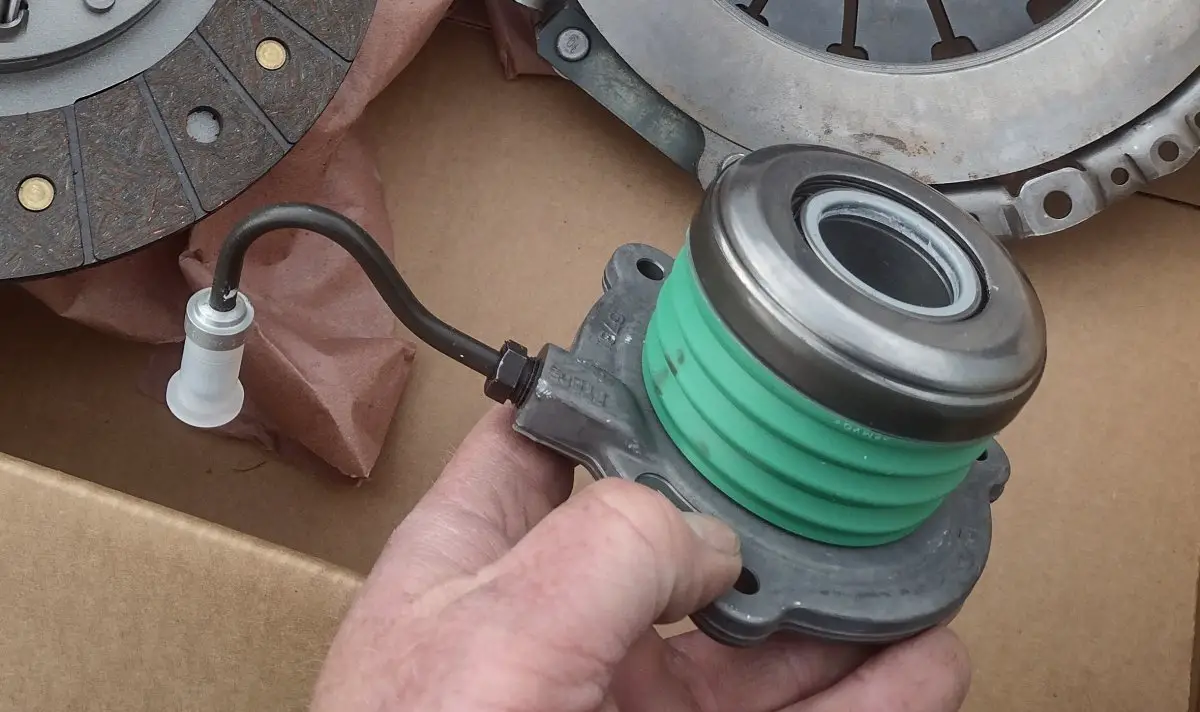

I have an 02 with a manual. and based on the trouble I had trying to find the parts in the first place, it's pretty rare. Everything seems unique to the 02. Anyway, I'm trying to bleed the clutch and having zero success.
The slave cylinder only has 1 line coming out of it, and that's for the brake fluid line. There's no bleeder. There is a fitting on the firewall that has a bleeder, but it's upstream from the slave, so I don't know how effective it's supposed to be.
I've heard stories about just pumping the pedal and it self bleeds I've pumped it maybe 100 times and it's not gotten any better. I've bleed the line with the screw on the firewall, and I get fresh, clear fluid out of it, but still no pedal.
I saw a video that talked about air in the clutch master, and given that my old slave basically exploded and drained the system, I suppose I should follow that procedure for bleeding the master cylinder that mounts to the pedal, but that still leaves me wondering how to bleed the slave. Every video I see is about bleeding the slave that has the bleeder screw on it. None of the videos for this single line cylinder.
I'll see what I've got for pics and try and attach some. In the meantime, if anybody has experience with the 02, I'd appreciate any input.
