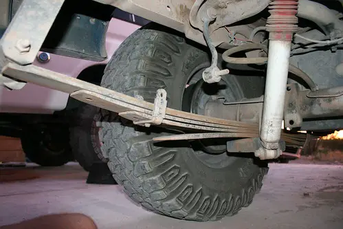

Looking like an S is bad. This is how it looked on our X before I rebuilt the spring pack.
I added a spring in the pack with one from an f-150 or explorer (I can't remember anymore) and I got some of the arch back (and less S-ness).
This is after I rebuilt the pack this time (I've rebuilt it twice now which is why I can't remember what I did anymore).
When they start to bend backwards they have a tendency to break (or at least more than they would if they were still a nice arch).
