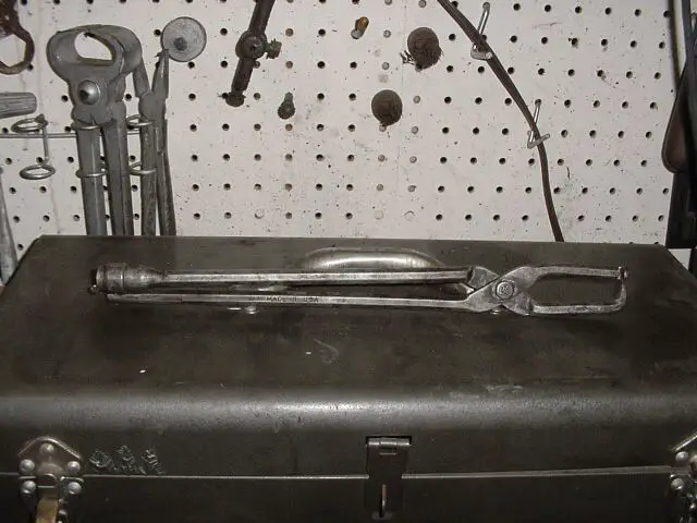

It's pretty simple and straight forward, just pay attention to the e-brake cable setup. A pair of these always makes the job go quicker, and I've taken a few people to the ER in the past who tried to get the springs back on and "slipped"

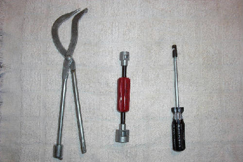

In addition to the specific tool TDG has posted, the other two tools in the pic will greatly ease your pain as well..lol. The red handled one will help to remove the smaller spring cups (2) per wheel, that hold on the shoe, and the black handled one will help you in reconnecting the larger springs that connect between both shoes. This one is adjustable. The little black end is threaded and tightens down on the spring without slipping. Seriously, you can do the brakes without these tools, but I highly recommend getting them for the job. Good luck.:D
