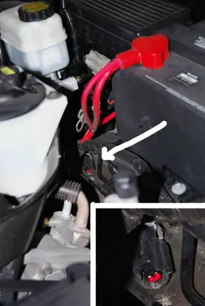

Start by popping the hood. No, we’re not going to extract the bearing from the backside, but the wheel speed sensor plugs into its’ socket inside the engine compartment where you can’t reach it from the wheelwell, forcing you later to either cut its’ cable off or climb up onto the truck and hope it doesn’t fall off the jackstands.
Here is Fords’ neat drawing of it, snug in its’ home aft of and below the battery, near the frame rail (I don’t know where it was on the passenger side):
Here is a photo of where I found it. I added the arrow and inset:
Notice there is a tab at the top, you have to depress it to separate the halves. Don’t ‘help’ it with a screwdriver.

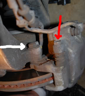

Take the 18mm, get behind the caliper and remove the two bolts.
This is a photo hunched over the wheel assembly looking straight down. Your target is the bolt marked with the white arrow (there are two, one above, and one [not pictured] below). Don’t mistake it for the one the red arrow points to. That’s a slider to compensate for pad width.
After removing both of the caliper bolts, take your mallet, and carefully tap the top of the caliper towards the right until you can see the top bolthole. Thread the coathanger you tied off earlier through this, and pull the slack out as you continue to tap the caliper loose. Tie it off and let the coathanger support the weight of the caliper, NOT the hose. Do not bend the brake line any more than you need to. You may need to separate the wheel sensor line from the caliper a little at this point. They just unsnap from each other.
