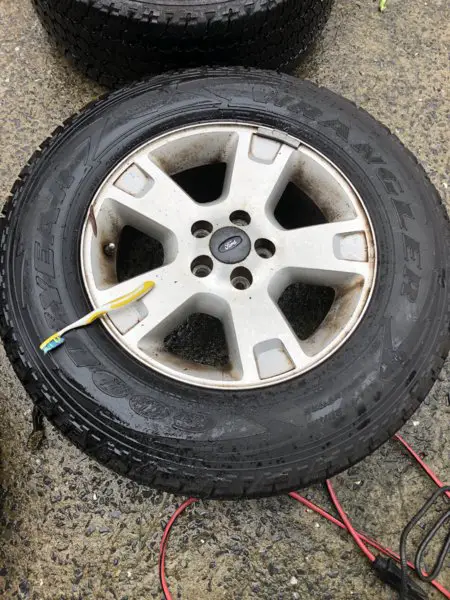

One day I went to clean my wheels and they wouldn’t come clean. The brake dust had baked on. I tried many different brand wheel cleaners and this crud wouldn’t budge.

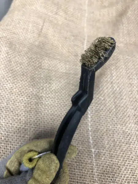

The other day, tired of looking at them, I decided to try one last thing, Purple Power. I can see you cringing now, those that know. Let me up the ante, I used a brass brush as well.

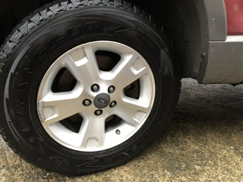

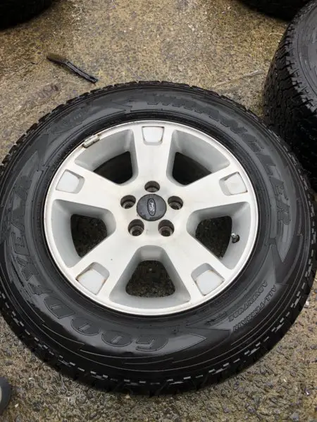

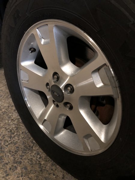

Here’s what I found, the uncut/though well used (degreased ‘94 Explorer engine parts with it) Purple Power cut through the brake dust like a hot knife through butter. I sprayed and almost immediately started scrubbing, dividing the rim into 5 or so sections, then hosed off thoroughly.
Now, I only used the wire brush on the rough surface, which is primarily where the brake dust was. I used a tooth brush on the polished portion. With the exception of the polished lip where the wheel weights set, I used the wire brush there too.
Did this with the wheels off the truck. Cleaned the back side of the rims as well as the lug nut wells.

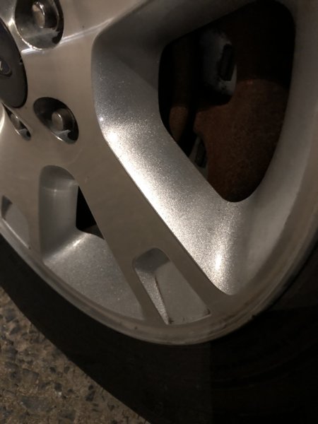

As my brass brush was well used, it didn’t get into corners well, as you’ll see there’s still some remnants where theres angles.
