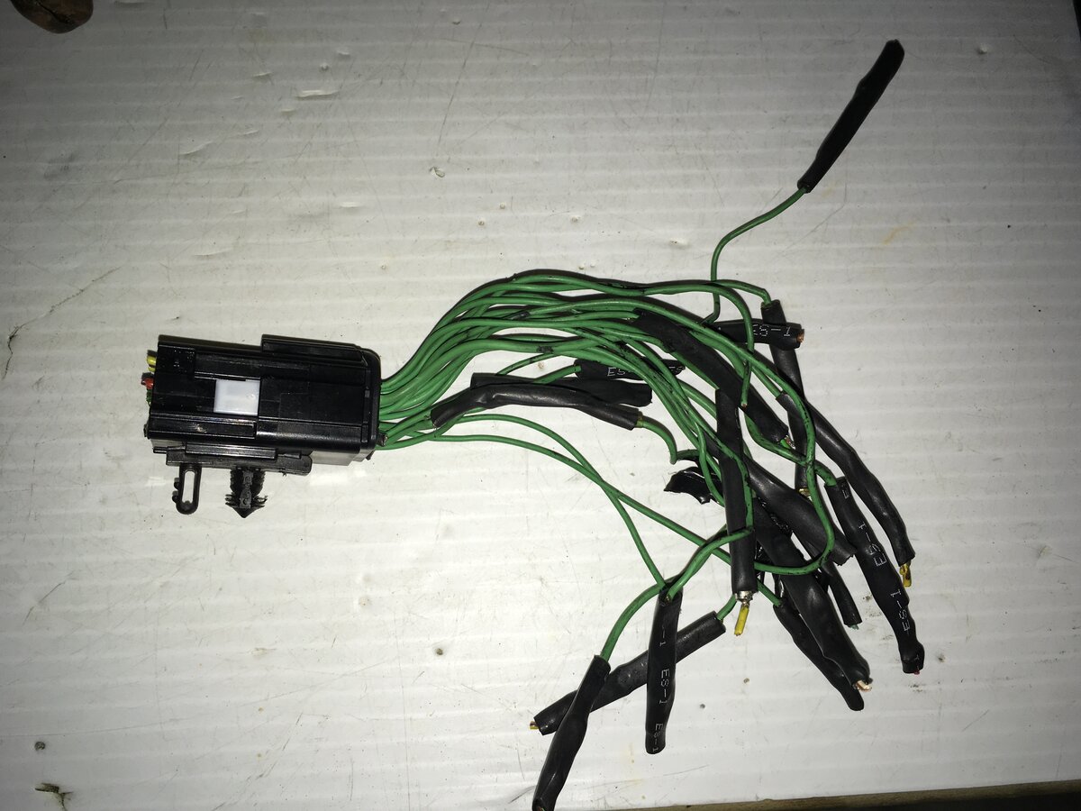

Wanted to see if the airbag light came back on after repairs 6 months ago. 2015 explorer limited with 24,000 miles. Used forscan and started to wiggle connectors all over the truck. Found the connector on the passenger side 2nd row bench showed resistance changes when moved. Cleaned the connections and applied chemtronics control cleaner to the contacts and no resistance changes afterward. I am a electronics technician with over 50 years of experience and do not agree with using dialectic grease on those connections. My belief is those connectors have very little friction to overcome the insulating properties of the dielectric grease.
Dielectric grease is an insulator, without enough friction the grease prevents a low resistance connection. I get why ford want to use it, to stop corrosion which can also cause a bad connection. The chemical named above not only cleans contacts it leaves a residue to prevent oxidation of the contacts. After applying the cleaner to the male pins (used a Q tip to apply even though it is in spray can form) the connectors were plugged and unplugged a few times.
The spray is made mainly for cleaning pots in stereo and radio equipment. And no, I do not have stock in this company,lol. Hope this helps someone with a reoccurring issue.
