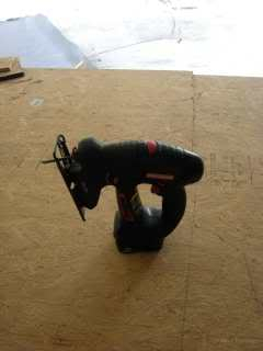

2) Jig saw or whatever you have to make the cut (circular saw would be best but I don't have one)
(and as a side note if you go and buy a saw for this don't get a crappy battery powered one this project took me a week to do cause I had to wait on the dang batteries to charge after every cut)

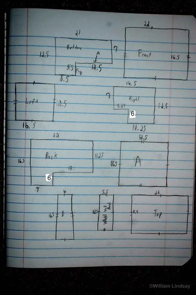

First thing you will need to do is plan it all out Here is a pic of my plans you are welcome to use at your own risk.
Link to cargo area measurements
After you make those it's time to start cutting. The best place to start is the bottom piece then cut out the sides.

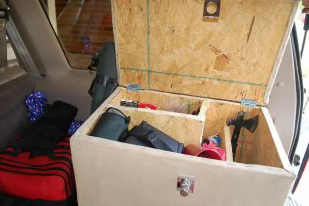

Pic of the whole box assembled minus lid.
Then you just have to cut a top and install the hinges and a latch.

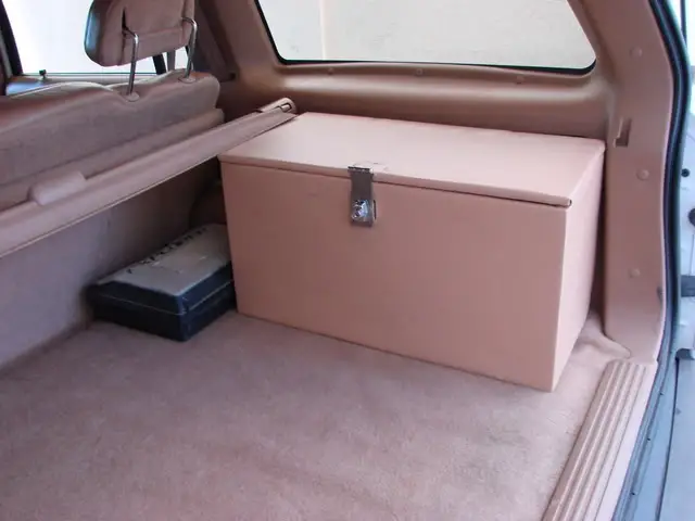

Finished box.

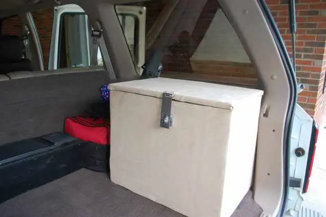

Finished product.

Bump edited orig post and added completed pics!
Just realized I never put in the dimensions of it; it is 13.5"W x 22"L x 17"H.

Nice work:thumbsup: and nice write-up. :thumbsup:
Just curious, how much does it weigh?
Sorry I didn't answer earlier. It weighs probably around 10lbs. It came out alot heavier than I thought but It stays put:thumbsup:,
Look nice. Is it bolted down in any way?
Just an update the box has been in there for a couple weeks now and it does need to be secures somehow.
I am thinking of just getting 2" long sheet metal screws and just screwing through the bottom into the floor??
What do ya'll think any suggestion's??
I still have a week till I can do anything since I'm not going home until the 10th.
I fixed the loose box tonight I just used 5 2" long screws and screwed through the box and into the floor. Now when you shake the box it shakes the whole truck.
