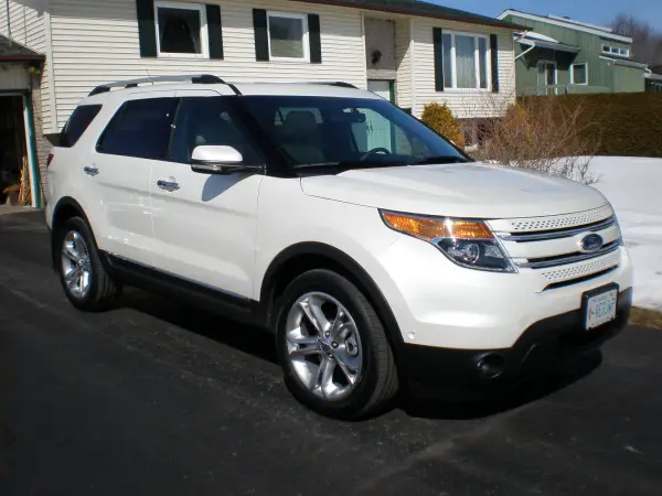

The book is where I got the Explorer II part and I'm quite not sure why is says that, but nevertheless it's an Explorer 2014 w/3.5l V-6.
Does it look like this? If so, it is either a Base, XLT, Limited or Sport. The name badge should be on the back liftgate.
Peter
