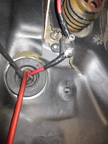

I started the project by pulling back the driver side carpet up against the firewall and locating a grommet passthru that the stereo shop had previously used. I decided that i could use the + Lead from the batter and attach it to the 20 amp fuse right there on the firewall and then run the positive leads to the Prodigy p3 and to a Black and Decker inverter that i have mounted in the glove box (previous project that didn't have a fuse or breaker)
Next I located the brake pedal 5 pin harness and tested the leads while plugged in to locate the 0 resistance pin (while brake is not in use) - I located the 2nd lead from the left (Red) and the 4th from the left (Green)
I decided the larger gauge Green was the most appropriate tie in. I added a butt connector here and had the lead from the P3 connected into this wire.
Now it was wire making time. I ran a hot lead with fuse from the alternator Red wire, and attached the Green wire to the Blue lead on the P3 unit (electic brake signal wire). I pulled both wires by the brake master cylinder and out the driver side fender area to wrap them together.

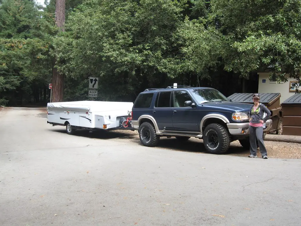

ok the Rig did an ok job pulling our new coleman pop trailer this weekend but the engine and tranny did run a little hot even after all my love and care.... and i am light on the throttle at least a lot lighter then i was in my young years..

Gotta love how the running boards are bent on both sides :)
Anybody got running boards and gold paint for sale?
Whoa, you're not riding spaceship from the trailer are you? please tell me you have saggy springs. You need to watch the weight distribution.
That is a good looking trailer, and she looks good too... oh and you're wife looks like a catch too :thumbsup: :P
Easy there, fella! haha
Yeah, I wonder if your lift kit is actually rated for lower TW than stock. You must have a lot of oncoming traffic flipping you the bird at night!
I highly recommend a WDH kit. If under 350 lbs TW, try the Reese/Drawtite mini-350, which includes integrated sway control. If TW creeps over 350 (like mine), I use the Reese/Drawtite 400 Single Bar, plus an add-on friction sway controller.
These will get you back to level, and more importantly, put weight back onto the front wheels. All of that lost weight in front could get you in trouble if you needed to make an emergency lane change (lost traction), and will also affect braking ability.
