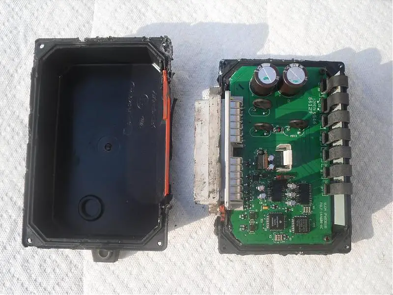

It would be interesting to see an internal view of the module before you install it. Do you have access to a frequency counter, and an oscilloscope to monitor the output (reverse engineer to see the range of the module)?
I do actually, that's how I was planning on testing it's output. The Ford WDS has a built in oscilloscope function that can record and view frew, amp, voltage, ect ect. It's a great scanner, and a even better electronics tool :D
Here's an internal view of one:

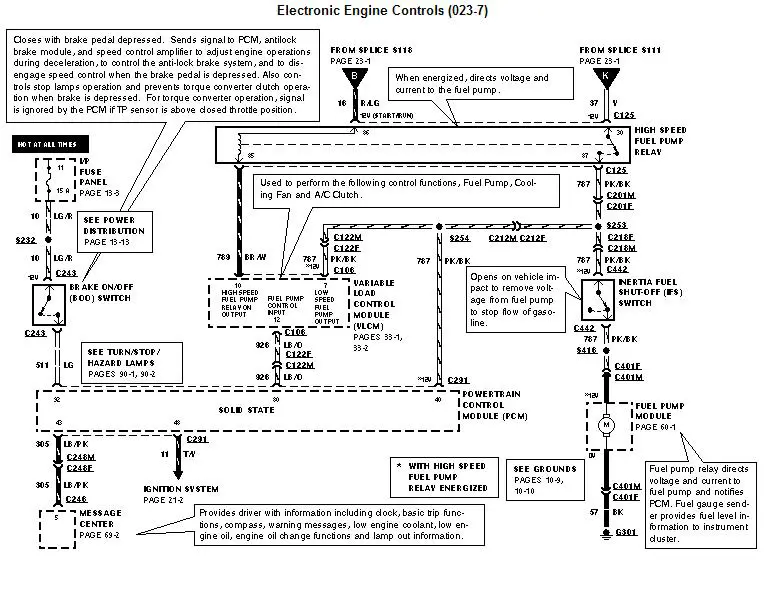

I notice there is a low speed and high speed fuel pump. There is a relay driver for the high speed pump. I wonder if the low speed pump rate is varied by the control module similar to the fuel pump in 3rd generation Explorers. If so, the control module could monitor engine rpm or maybe calculated engine load. I doubt that fuel pressure is available.
A 40 amp fuse for the cooling fan probably means the designed max current draw is around 30 amps. Is the Mark VIII cooling adequate in warm weather, with the A/C running and in city traffic?
Take a look at part of the EEC wiring below. There is only one fuel pump, but why is there something called high speed and low speed? High speed looks like a full 12 volts, where as low speed could mean like you said, the fuel pump speed is varied based off of the VLCM?
