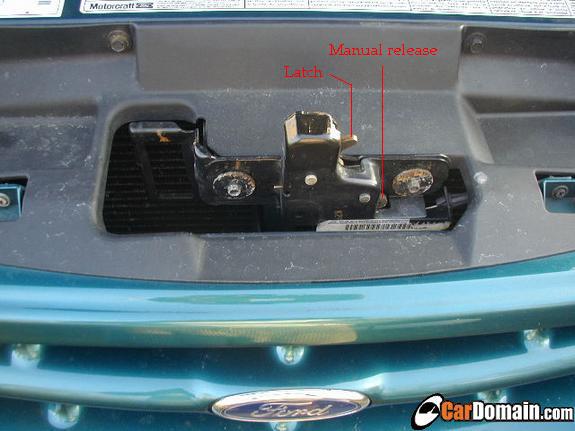

I just went through the same thing on mine. It took me an hour to figure out that there's a manual release on it. It's a little tricky to find, but once you know where it is, it only takes a few seconds to pop. It looks like a little hook in the bottom right corner of the latch. Slide a flat head screwdriver through the grill, between the latch and the hook, and twist it to the right. Here's a picture:
Awesome! ill try the screwdriver!
this is THE BEST WAY. so easy a baby can do it .Thanks alot !
So easy to do, follow pic ,worked on my 1995 ford explorer limited 4x4. Now I may not get cable fixed.ps keep alarm on.
