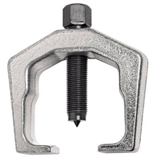

I have found that this tool is VERY useful for getting upper ball joints "unstuck" on my 2004 when a ball joint separator, PB blaster for several days, heat, and beating the hell out of it with a minisledge wouldn't work:
Pittman arm puller
For lowers ball joints, I have had just as much trouble but the Pitman arm puller won't work. Instead, use a 7 ton gear puller:
The Pittman arm puller fits right in there for the upper and is pretty easy to use. The gear puller takes some patience, but you can get the gear puller and arms lined up on the bottom of the wheel knuckle and press the bottom of the lower ball joint out.
When doing both, remember to put the castle nut on the very end of the ball joint. It will double as a guide for the pullers to be put into the right place and will also give you a little more surface area to press on.
