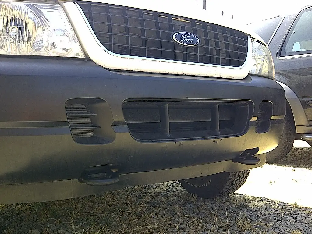

Black it is! Freshly powder-coated too.
Just finished putting them on. Its still in the garage so it was tough to get far back enough to get a decent pic.
just stole a pair off an expedition at the junk yard, paid $20.00 got em on in about 15 mins.
got mine with all the hardware (bolts and the threaded plate) all thats needed for that is loosen the 4 bumper bolts to make a big enough gap for the plate to fit through and bolt it up looks good and will def. be put to use lol

Here's my X now with Tow hooks, time to change my signature with another mod... jajaja :D... It took me more than the average here to install them but it was because I'm pretty newbie for all mechanic stuff and I took the bumper off.
P.S the blocks for the 1.5" BL are coming my way and now I know how to remove the front bumper, also a flowmaster 40 is coming as well... :thumbsup:

Looks great, Those holes in your bumper where the license bracket use to be , can be covered with those black plastic push pins used to hold trunk panels in place. Can also be painted to match truck color.
