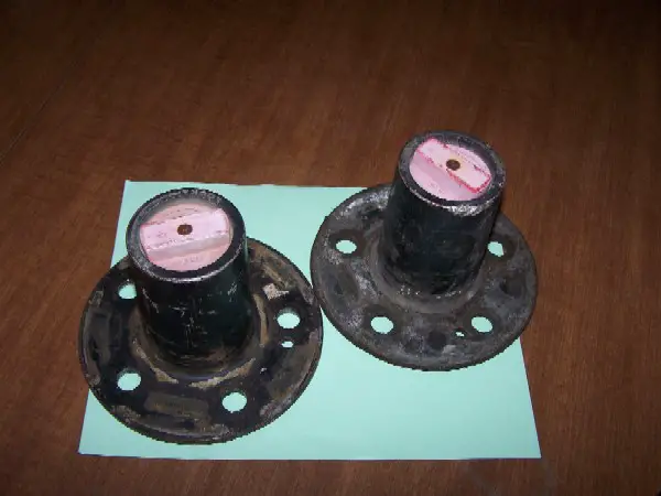

Here are pics of the hubs for sale.
They need to be cleaned and painted, but are mechanically sound and work. I would have cleaned them, but I can't work in my workshop right now.
These were my backup set that I carried on the trails in case I blew one.
And, sorry, they do not have the conversion nuts. Those can be orderd for low $$$ from Napa. Here's the part number:
http://www.napaonline.com/MasterPag...mber=6301653&Description=Spindle+Lock+Nut+Kit
The ones for a Dana 44 from a Bronco are a direct fit to the Dana 35 spindles in Explorers.
Right now, tbars4 has first chance at the hubs, followed by dllb if tbars4 doesn't want them.
PM me with zip code for shipping information and I'll calculate shipping costs (no padding costs -- you pay what I pay).

Those look like D28 hubs.
