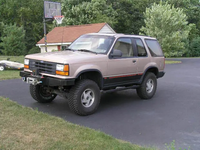

The confusion exists because there is difference between what is recommended and what people are using. What is even more confusing is the shop called BFG which indicated 12.5s would fit on a 7" rim. This is confusing since BFG's Tire Spec Chart for the TA KOs indicates a 33x12.5 tire's recommended rim with is 8.5-11 inches. :confused: I would suspect this recommendation is for maximum tire life, balance, handling etc..
As mentioned by JDraper several members have run 33x12.5s on OEM 15x7 rims without any major issues. I would venture to say the most popular rim choice 12.5 wide tires is 15x8 rims with 3.75BS. This configuration orients the tire in a position very close to stock. See diagram below..
Click on image for full size.
