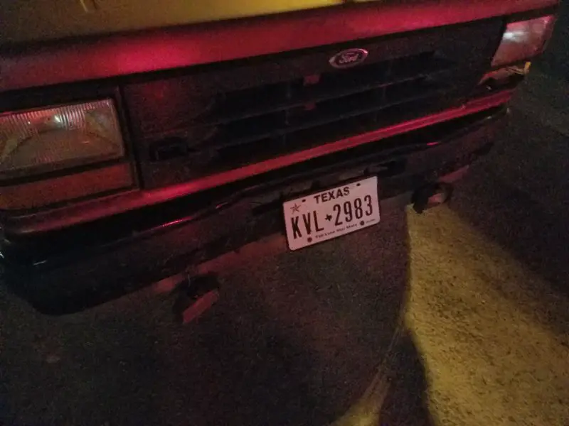

Welp.. just got home. No injuries to anyone, most important thing. Cars were both able to drive away.
How does the damage look? Ill have to get a better look in the day light. Damn.. my brakes just locked up!
I was thinking, because the fender is close to the tire now, of pulling the whole damn front end with a come along. Radiator was unaffected, havent checked the AC because Texas froze over early this year.
All the lights appear to be working and uncracked miraculously.
Any thoughts? Come along next to a tree and just yank or perhaps drive a short distance in reverse to yank it out?
Thanks yall..
Minimal
Yes you can pull that out
Or you can just buy aftermarket bumper for like $100

That's not too bad. But if your fender is close to the tire, then there could be some minor frame damage. Just pulling with a come-along from a tree will not do anything unless you have the other end of the Explorer anchored somewhere else. By that, I mean one come-along off the front tied to a tree, and another come-along off the back tied to a tree (or other anchoring point). Then you can slowly ratchet things out. That's how the old-school frame bars worked. My Dad had one back in the day.
If you only have the one come-along and only one tree within reach of the Explorer (can't find a 2nd anchor point close by), then you can tie it up and use Reverse to help yank it out. But be careful. This is very jarring and could potentially damage other things. Especially if you get a small running start and yank too hard. You could also rip stuff off.
