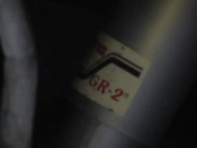

Gr-2
01 Sport - KYB shocks
03 XLT - KYB struts
No complaints.
