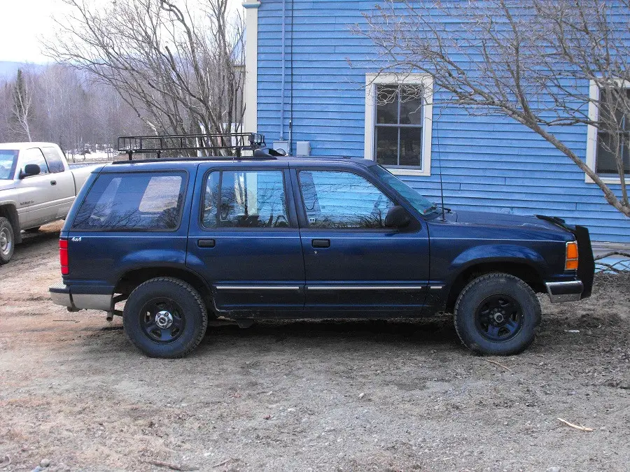

the cherokee wheels do fit, the center bore is actually a perfect fit over the hubs at leats on a 1st gen. i use steelc herokee wheels on my 91 for winter rims and there are several cherokees in town with 2nd gen explorer wheels on them. i had not tried the s10 rims before, i have just been told they would fit. thank you for the correction.

i thought the center bore was smaller on the 2nd gens because they dont hav e the same type of hub. but i have never really bothered to check.n i have seen 1st gen wheels on a 2nd gen also, like the stock throwing star style, and the center bore is exactly the same between the cherokee rims and my stock ones.
