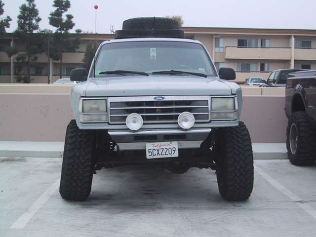

Also a 94 with very bad sagging coils. Knew it was the coils causing it since the tie rods werent straight, were balljoints i would think they would remain close to straight... but i dont know how correct that is its just my own observation.

I have an old car given to me from my dads friend, he occasionally asks how its running. Ive kept it running still and had my fun. Im going to eventually get a 350v8 for it (instead of the 307) just for a weekend driver. I have yet to hack and slash anything (except exhaust hehehehehe). It will also recieve nice wheels and a flat black paint job. True duals would also be on the way since its over 20 years old im emissions arent a problem :D... anyways enough rambling on about it ill save it for another thread for another day when i get the thing to start again (bad ground from battery).
