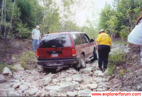

I heavily wheeled my '01 XLS with a 2" TT/Shackles and stock length shocks for several years. Never blew out a shock and took it places that most people wouldn't dream of...
