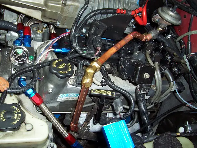

I purchased a used ignition coil pack and have started thinking about a way to delay the PCM to coil pulses to fire the second coil pack. A variable delay based on engine rpm would be more effective but also more complicated. A fixed delay would be a good evaluation project to determine if there is any potential fuel economy or performance improvement from a second spark. Some members have reported idle stability improvements from ignition upgrades.

That's a good question! It is my understanding that the voltage output of the stock coilpack is adequate for normal max engine speed (6,500 rpm) and modest boost (8 psi). However, for best fuel economy and best performance (especially at high boost) the spark duration needs to be increased. The high voltage spark is created when the electromagnetic field in the coil secondary winding collapses due to the current in the primary winding being interrupted. The duration of the spark is dependent on the amount of energy stored in the coil secondary which is a function of the amplitude of the current flowing, the time the current is allowed to flow, the number of turns, and the volume and type of the ferromagnetic material. The waste spark system used in my Sport with only three control wires fires any individual spark plug twice as often as necessary (on the compression stroke and the exhaust stroke) reducing the time for a coil to build an electromagnetic field. Using two coils for each cylinder with one coil firing slightly later than the other would extend the effective duration of the spark. Using COPs instead of coilpacks would reduce the amount of high voltage ignition wiring but I don't know if there is room for two COPs per cylinder. It is definitely something to evaluate.

Not yet. I started this thread before I decided to add an M90 supercharger. However, I left room to install a second coilpack above the stock coilpack. One of my work tables is covered with ignition wire sets, coilpacks, an ignition module, an electric motor driven trigger wheel and an oscilloscope waiting for my attention. I may get back to it after I finish building and installing an Aviator 4.6L DOHC V8 in my 2003 Explorer. I'm now 70 years old and am trying to focus on heavy duty projects now and save the light duty projects for when I get old.
