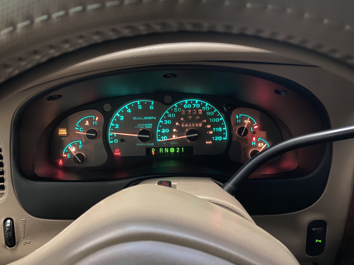

Thank You for this directions. I was able to use them to successfully swap out my OEM cluster for my new cluster out of a Saleen XP8 Ford Explorer.
