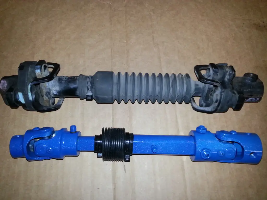

It may be easier/cheaper in the long run to just make your own custom length steering shaft with two u-joints:
http://www.explorerforum.com/forums/showthread.php?p=2916830
You could also scrounge around for other RBVs with the double u-joint stock steering shafts:
http://www.explorerforum.com/forums/showthread.php?p=2878148

I do remember the flaming river shaft but it is $300!

90 explorers came with double also.
$300 made me cry also but its night and day difference! !!
O and it sure is purrdy:D

Yea that why I said you may have to use a double joint but they run near $200.for that price you can almost build a whole shaft
http://www.flamingriver.com/index.php/products/c0005/s0002/FR1794PL
