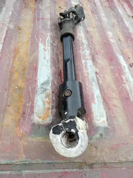

I picked up 2 different ZJ shafts and neither of them have a large enough opening on the column side to go over the column coupler. Am I missing something?
timtimtimajim
May 29, 2014
535
175
Colorado Springs, CO
1993 Explorer Sport
Make sure you’re pulling the shaft from a 94 or earlier ZJ. The shaft changed in 95 and won’t fit on the steering column side.
Xeek
March 21, 2010
2,984
16
Virginia Beach, VA
1991 xlt
Is there a method to noticing the right one? The one I bought says 93-95, but it doesn't fit on the column side. But I noticed mines pretty recessed where the bolt goes, vs the one in the original post is flat on the whole side. Which I notice wouldn't even allow me to drill the extra hole to use the factory connecting hole on the column side.
Every other shaft on eBay when I look up a 93 is this way.
Four0Sport
Jack Pewe
August 26, 2004
3,028
92
West Virginia
1993 2dr
i purchased 2 and neither will work with my 93 column
