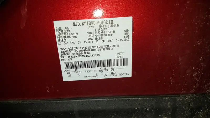

The issue here is the specs of OPs trim level do not match the tow package specs - which obviously means his vehicle isn't rated correctly and what he's doing is rather dangerous. His insurance company would probably go to town on him for doing so.
OP - the factory tow package isn't just the oil cooler, trans cooler, bigger brakes, and bumper covered hitch. The transmission is also completely different. Yours should be a 6F50 trans, whereas w/tow pkg it should be a 6F55.
I've attached a picture of my VCL as well as the breakdown for the Transmission code designation in the Owners Manual (pg 338, under "Capacities and Specifications").
