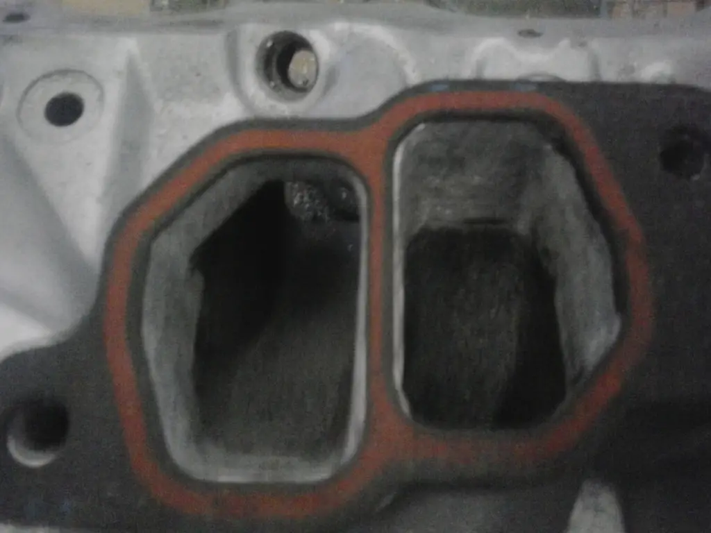

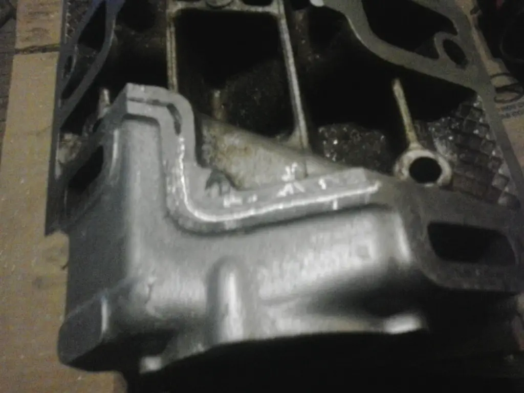

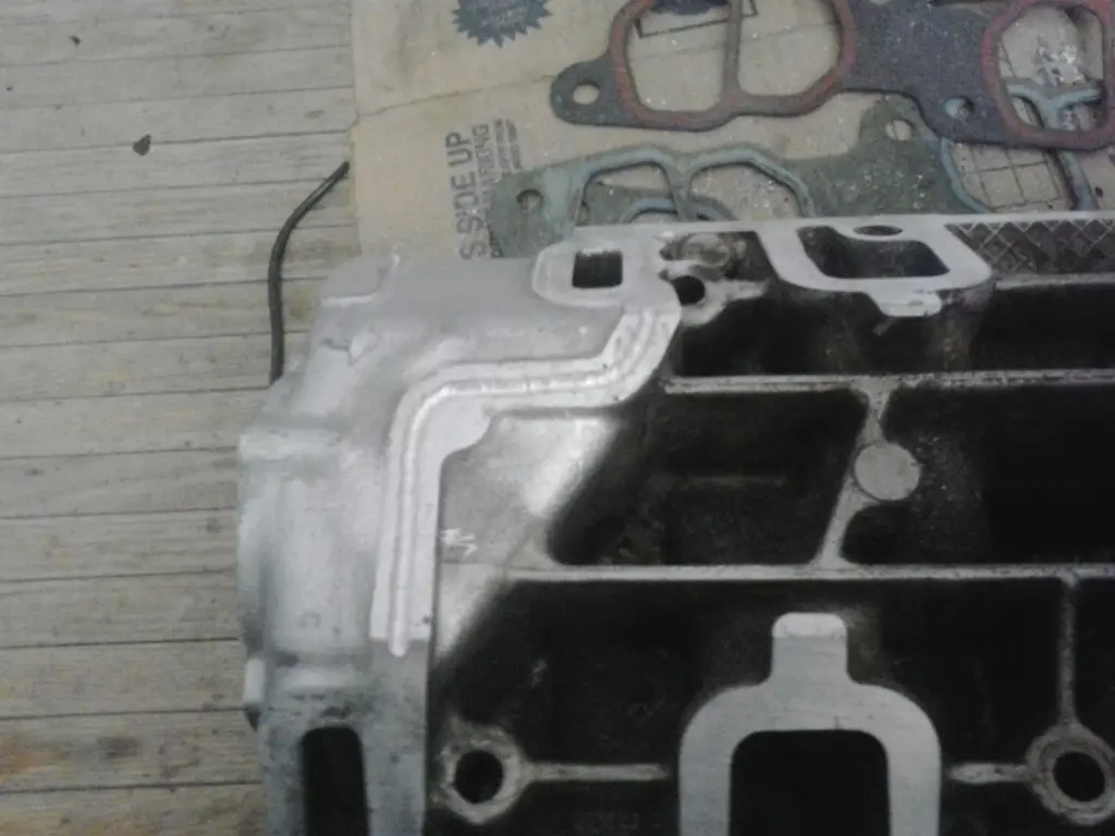

I went ahead and grooved the ends of the manifold, still may groove it around the coolant ports.

I would never loctite manifold bolts. You are lucky to get them out without breaking as it is.
I like the machined groove idea. Hope it works as intended. :thumbsup:

Ditto on both comments. The groove turned out better than I imagined. Nice job.

Thanks guys, its a winter project :D. The throttle body, and upper intake are done, still have the heads to do and hopefully they are not cracked. I won't be using loctite on the intake manifold bolts but will install studs in place of the bolts. I have decided to continue the grove around the coolant ports. Will continue to keep updating this thread on my progress and the eventual outcome.
Finally finished the rough machining, still got alot of polishing to do. Here are some pics.
